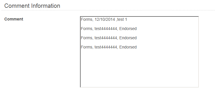

The sample I provided before is just a sample to show that you can get comment from different steps and combine them together. If you want get other information as well as comment, you can use similar method. For example, you can add separate single line fields and set their default value as {/dataset/_submitter_displayname}/{/dataset/_submission_time}/{/dataset/_action} and hide them on the form, and then use following script to get the default value and display together in a multiline field:
  var com = $('#q2 textarea').val();
//get previous comment
  var com2 = $('#q1 textarea')[0].getAttribute('default-val');
//get previous action participant
  var displayname=$('#q3 input')[0].getAttribute('default-val');
//get previous submission time
  var submissiontime=$('#q4 input')[0].getAttribute('default-val');
  var action=$('#q5 input')[0].getAttribute('default-val');
//combine the information together
  var currentinfo="";
  if(displayname!=null){
        currentinfo=displayname+", ";
  if(com2!=null){
        currentinfo=currentinfo+com2+", ";
  if(submissiontime!=null){
        currentinfo=currentinfo+submissiontime+", ";
  if(action!=null){
        currentinfo=currentinfo+action;
//append to field that display the information
if (currentinfo!=""){
  com = com + '\n\n' + currentinfo;
  $('#q2 textarea').val(com);
  $('#q2 textarea').attr('readonly', 'True');

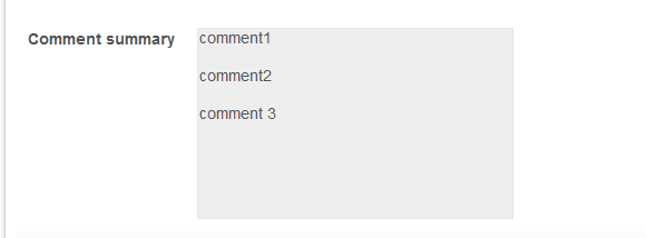

Are you use same form for different steps or different form for different steps? I tested to use same for form 4 user tasks and use following JavaScript to only display the comment, and it works for me
if (com2!=null){
  com = com + '\n\n' + com2;
The screenshots is the comment summary in user task 4:

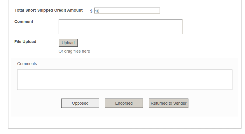

In place to use a comment Inside the form, I would like to use the one that it is add automatically by forms and appends this comment to a field name sumary comment.
what is the variable of the default form comment that it is added with form and not create by using a text field. look in my sample image, there is a field named comments but also another one that is added by the forms system.
So I would like to get the value of this comment forms system field and append the info on the created comments field in the next approval business step
