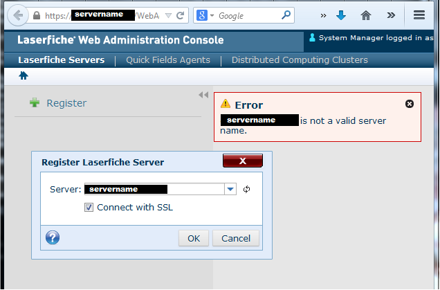

I am trying to register a server in the Web Administration Console. It happens to be the same name as the site. Yet the console tells me it is "not a valid server name" what does this mean Laserfiche? Everything else can see the server name.

The machine name had "_" characters in the machine name. HTTP protocols are not friendly to the use of "_" in a URL. The machine name was changed to use hyphens "-".
Then I rebound SSL (443) to the certificate, retracing the workflow above.
When I tested the Web Admin console it connected with no issues, including windows authentication.

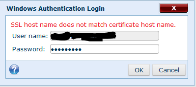

Yes, but then I get a certificate error when drilling down in the menu to log into the repository. The certificate is a domain certificate issued to the machine FQDN and matches.

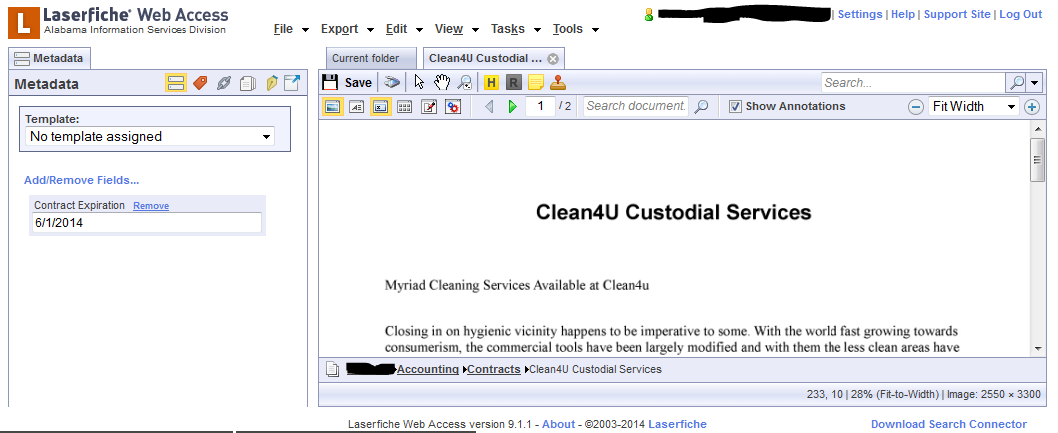

Yes, and it connects and I can browse the folders/files. In this case all LF products are on the same machine / same certificate.
Connected to view a document and metadata:

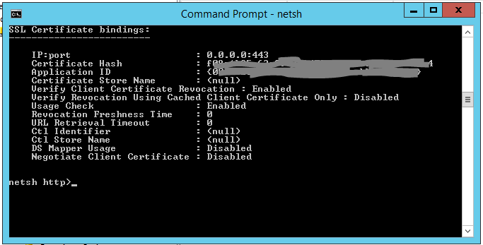

5. Open a new command prompt window and go to C:\Windows\System32. Then run the following command
http add sslcert ipport=0.0.0.0:443 certhash=thumbprint_value_without_spaces appid={00112233-4455-6677-8899-AABBCCDDEEFF}

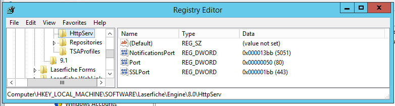

6. Now go into the registry to HKEY_LOCAL_MACHINE\SOFTWARE\Laserfiche\Engine\8.0\HttpServ
7. Create a new dword called SSLPORT and set the value to be 443 (decimal)
8. Restart the Laserfiche Server service
9. Open the LF Admin Console and register a new LF Server instance using v-sup-2k8r2-2.laserfiche.com (the fqdn of your actual computer name) and make sure to also check the "connect with ssl" option
replied on December 9, 2014
Based on your earlier screenshots you have items 6-8 already.  Just skip to 9 at that point and try again.
I think this is already in place. What are we specifically looking for? I checked the Hash on the certificate and the netsh binding. They match. I don't mean to be dismissive, but I'm looking for the specific change that you feel is not taken care of. I have run through this workflow before. THANKS - I'll come back to this tomorrow.

Here are some error events reported in Chrome Developer Console and the Windows Event viewer that are associated with this issue.
Chrome Developer Console:
  1. ExeptionType: "System.ArgumentException"
  2. Message: "Value does not fall within the expected range."
  3. StackTrace: " at WebAdmin.QuickRetrieval.RepositoryManipulate.RegisterServer(String serverName, Boolean useSSL)"
Windows Application Logs:
Value does not fall within the expected range. 12/11/2014 7:32:12 AM: User: <<my user was here>> URL: https://<<my_server_was_here>>/WebAdmin/lfs/Home.aspx Message: Value does not fall within the expected range. Stack trace: at WebAdmin.QuickRetrieval.RepositoryManipulate.RegisterServer(String serverName, Boolean useSSL)
Firefox Browser Console expands to show the error associated with "QuickRetrievalHandler.aspx"
"GET https://<<my_server_was here>>/WebAdmin/QuickRetrievalHandler.aspx"
There is no documentation on Google or Laserfiche Support for "QuickRetrievalHandler" or "QuickRetrieval".
