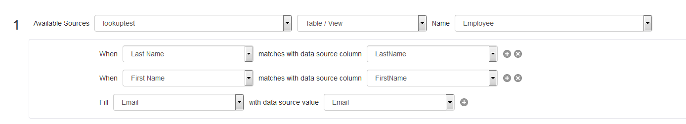

replied on December 7, 2014
So you have added "lookupCondition" this css class to all the condition fields used in a single lookup rule?  Can you share what the lookup rule looks like? I used two fields as condition for lookup with "lookupCondition" css and used same code as yours and can't reproduce the disappear issue.
