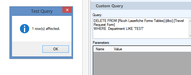

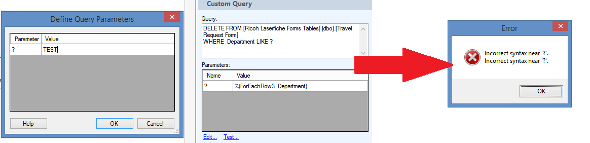

I am using MS SQL Express to store Department Travel Request information, being used with Forms and using Workflow to Delete, add or change records.
To Delete records I am having trouble with the Custom Query. If I have hard code values into the query it works perfectly when Tested. But when I use Parameters using the '?' it returns the error "Incorrect syntax near '?'".
See attached for screen shots of both types.
I have manually typed in the query (eg not copied/pasted). I am an absolute beginner at this stuff, so does anyone have any ideas?

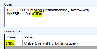

Looks like the data connection needs to be ODBC and NOT Direct. Before doing that, first try changing the parameter FROM '?' to something with this format @parameterName. Example:
To be clear: Direct SQL connection you can use parameters, ODBC connections you can only use '?' as parameter name.
