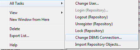

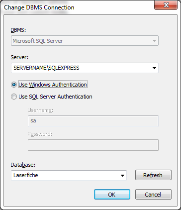

Sounds like the SQL DB server name will need updating if this has changed. Open the Laserfiche admin console and right click your repository. From there go to All Tasks>Change DBMS connection
From here you can update the server name where LF looks for the database. Update the below where SERVERNAME is the name of your server. You will probably see the old server name there and know what to update.
You will probably need to re-start the Laserfiche Server Service after selecting OK (or re-boot the server, whichever is easier).
