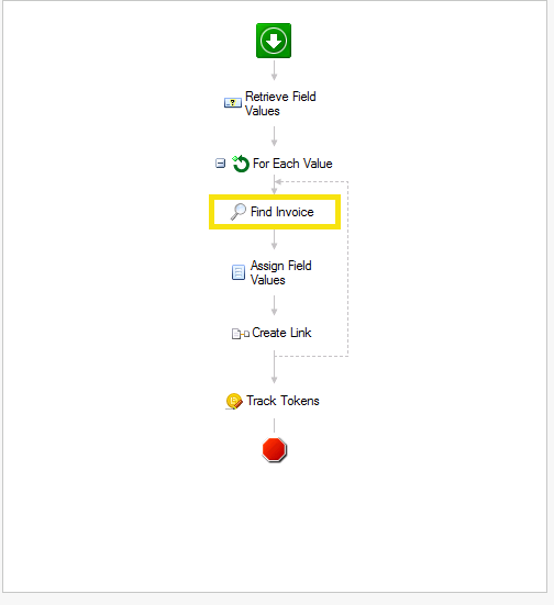

I don't see how that would work me. I just might not be that creative. Here is my workflow. It is fairly straightforward. I am having an issue which i have opened with support, where the Find Invoice only work sometimes and fails to find it otherwise. My Search criteria works in Client when i enter the same value it is getting from the for each value.
replied on November 20, 2014
Nevermind, I see what you are saying about the result count. I do think that is going to work for me. I was initially thinking that it would only give me the total it was attempting to iterate, if that makes sense.
