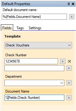

replied on December 2, 2016 • Show version history
Would someone be able to elaborate on Berts response? I have created a Document Name field, I want this field to get its name from another field called Check Number. My goal is when someone types the Check number in, a token names the Document Name field, and my default document name would be assigned to the Document Name field.
