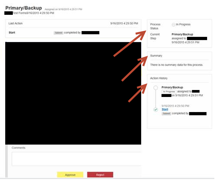

replied on September 16, 2015
Has there been an update to this? A client would like to have the option to move the action history to the top of the screen to free up realistate on the right side that shows the Summary, Action History, etc.
Hi there,
Are you referring to the saved document or the view task webpage?
replied on September 18, 2015
Hey Abby,
Thanks for the reply. Here is a screenshot with arrows pointing to the areas that we were hoping to be able to move/remove to clear up more space to see the form.
Thanks!
It would be nice if you could add an arrow attached to the right frame that contains that information that could be clicked to collapse or expand it. Just like when you're in the Process Modeler and you don't want to see the names of the activities in the right pane.
