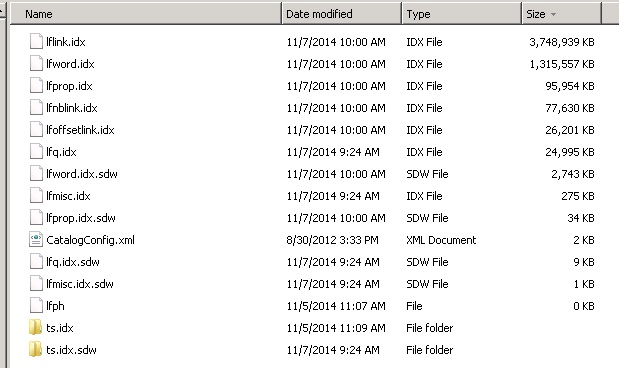

The attached shows the size of our index files.
