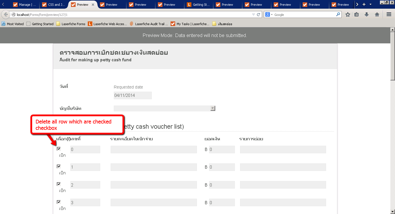

Hi every one,
I have a problem with delete rows of table and rows of collection filed.
I wish to delete row not only remove data but also delete the row of table.
So I use:       $(this).find('.form-del-field').trigger('click');
instead of     $(this).closest('tr').remove(); or $(this).closest('tr').hide();
 Down there is my code to delete some rows which are checked checkbox
 $('.cf-table-block').ready(function(){
    $('.cf-table-block tbody tr').each(function (){
            if ($(this).find('.PCVClick input').prop('checked') != true){
but It doesn't work.

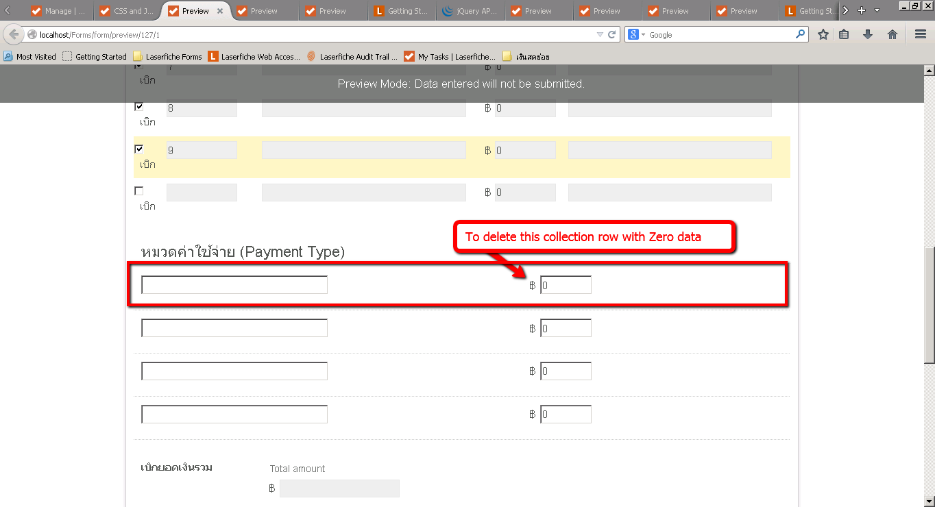

And I wish to delete collection row (which has a condition ,such as a row with zero data in a field)
My code:
 $('.cf-collection-block').ready(function(){
 $('.cf-collection-block ul').each(function (){
        if ($(this).find('.TypeAmount input').val() == 0){
             $(this).find('.cf-collection-delete').trigger('click');
And   it doesn't  work,too.

Sorry Bongkoch,
I was troubleshooting just by looking at the code, and not running it. I built a small demo form and found the problem fairly quickly. The collection doesn't use a list to manage the repeated sections, rather it is just a bunch of nested DIV tags. We'll need to change the each() function again. Also... I don't think parseNumber() is a valid function, as far as I can tell. You may have to use either parseInt() or parseFloat() depending on what you are expecting for input values. Hopefully this works for you:
$(document).ready( function() {
   $('.Submit').on('click', function () {
      $('.cf-table-block tbody tr').each(function () {
      $('.cf-collection > div').each(function (){
         if (parseInt($(this).find('.TypeAmount input').val()) == 0){
6 0
