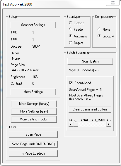

replied on November 13, 2014
Hi Miruna,
I am still having some trouble with this scanner. I am unable to find the "ScanAhead" feature for the TWAIN driver. However, I did find it for the ISIS driver for this scanner.
The problem I'm running into now is that if I use the ISIS driver with LFScanning, no image comes through at all. An entry is created in the Scanned Documents list, but there is no image at all. Another issue is that the scanner scans on page at a time with a pause of about 1-2 seconds between each page.
So, I found this scanner app: C:\Windows\pixtran\Testappn.exe and used it to test with. I assume it's for ISIS only?
As you can see below in the screenshot, it has an option for ScanAhead. When disabled within this app, the scanner behaves "slowly" just like in LFScanning. When I enable ScanAhead, then it scans normal and fast. However, this app does not display an image, it simply shows a message that says X amount of pages were scanned.
So, in an effort to try and use ISIS as an alternative option in my troubleshooting, I have run into this problem.
Now, this ScanAhead feature is not accessible to me in any of the LF Scanning settings available. It seems it exists within this test app only.
Any ideas?
Thanks
Sheldon
Yes, using the Testappn.exe app, when turning off the Scan Ahead feature it behaves very differently. It scans a single page, waits 2 seconds, then scans the next page etc. When enabled, it scans normally. However, this setting is only available inside this standalone app, there does not seem to be a setting for it elsewhere.
When using the ISIS driver in LF Scanning, it behaves the same way, scan once and wait 2 seconds.
I have seen the feeder timeout option and I have disabled it in the TWAIN driver. This does not seem to fix the problem.

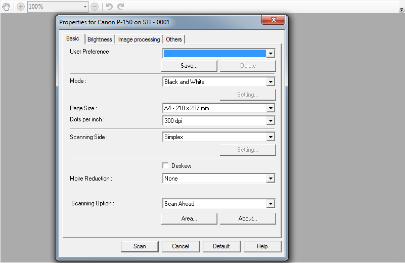

replied on March 10, 2015
Hey Sheldon,
If you go to File>Scanner Options and select "use default scanner software" and then hit scan then you should get this options window.
