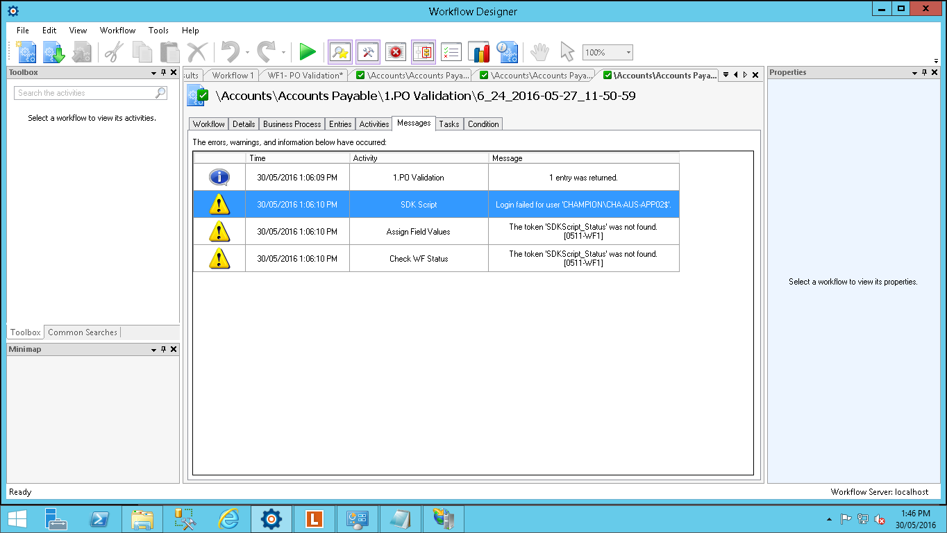

Hi Miruna,
Now i have another error when i execute the workflow <SDK script error>. It says login failed for user.
But  when i execute the script from the script editor it is inserting the record in the database.

replied on May 29, 2016
The Windows account that the Worfklow service is running under is likely different than the account that you are running the Designer under.  If your SQL connection string is set to use 'Integrated Security=True' then SQL is trying to use the Windows account that the process is running under.  In this case the account that you are running the Designer under has the appropriate privileges and the account that the Workflow service is running under does not.
You can either add the Windows account that the Workflow service is running under as a trusted account in SQL or you can 'hard code' a UserId and password into the SQL connection string.

Hi Cliff,
As you said, I have changed the Designer's account which has permission to access the server.
Thanks a lot cliff. It  worked ..

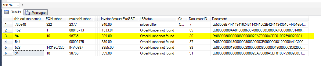

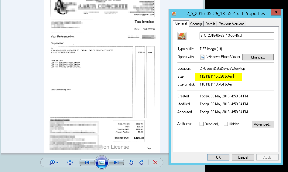

Further testing, I am able to insert the image in sql successfully. refer image <record in sql.png>
But the file size is very small for a tiff file. It shows 94 bytes but the actual file size is 112KB refer  image  <image size.png>.
Is it the same way it came when you tried ?
The sql database that we are writing is a staging database for a third party application to read. We dont have access to that application. To validate that we are writing the image correctly could you please guide me on how  to view that image from sql ? or  suggest a tool if any to view ?

replied on May 30, 2016
The difference in file size would worry me as well.  I would do a quick Google search for exporting an image file from a SQL table to get some ideas.  (It doesn't look like SQL has a native way of viewing image data but it looks like there are SQL scripts that you can run to export the image data back to a local share and then use image viewing software to open the exported file.)
