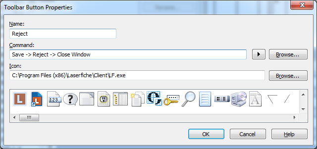

The Business Process button works, but I was wondering if its possible to expand on it slightly to really perfect the idea.
In the Custom Toolbar Buttons section. Is it possible to Call Save -> Call the Business Process -> Call Close WIndow all from the same Icon?
If so, where can I find the Commands for the calls within Laserfiche? Would I have to write a custom call to combine all 3 or is there a separator for the Command Line shown below to use 3 separate command in order?
I like that i can use the Business process from the Main Laserfiche window without having to hit save and close on the document viewer. However if a user were to use the document viewer window, they could use the "All in one" button to kick off the workflow and close out the window.
This would also allow for customizing the Business Process button by using the custom Button to run the Business Process, since the Color Coded Business Process icons are quite utilitarian.

I tested the business process buttons and they will work for me. And I understand that you cannot build the close window into the business process.
What I was asking is if you can combine the Keyboard Shortcuts into one button. For instance there is a Close window Keyboard shortcut, and there is a Save Keyboard shortcut. So I was asking if the commands which are called from hitting a keyboard shortcut are readily accessible. If so to expand on that idea, I was inquiring if you could combine the commands for Save -> Business Process -> Close window all into one Custom Button. (As shown in my screenshot, with functional names rather than the real command.)
replied on November 3, 2014
Hey Justin,
That's not possible because there's no way for Laserfiche to know what order to perform the several actions tied to the same hotkey.  An alternative would be to have something like CTRL+1, CTRL+2, CTRL+3 each set up to run a business process, save, and close respectively.
