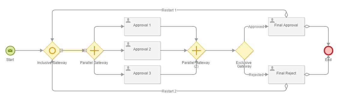

- The inclusive Gateway was added to simply loop back on the process instead of starting a new BP for each test.

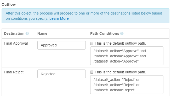

- On the parallel gateway, the conditions are set this way:

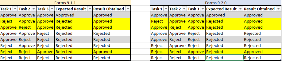

With this setup, I've gotten the following set of results:
Upon testing, figured out that the "Action" on the parallel activity can be changed and invoked individually from each User Task by changing the label (instead of calling it just "Approve", can be changed to "Department Approval"), but then any condition added would result in an error on the event viewer "Message: Routing cannot be split to any subsequent branch. XPath evaluation may fail for every possible condition".

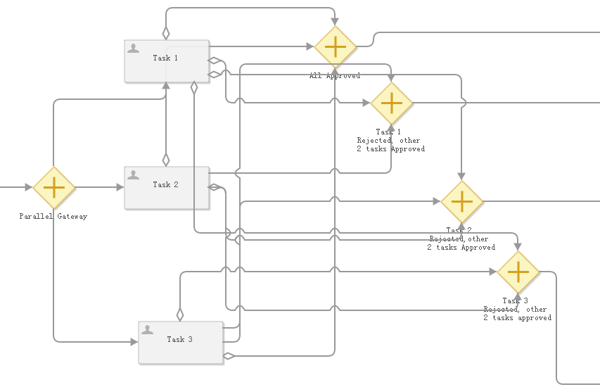

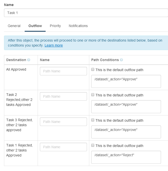

As Eric pointed out in the original post, use the "/dataset/_action" to check multiple tasks processed before can't work, when process to the Exclusive Gateway, there is only one item for dataset/_action which is from the last task perform before(in your case, it is Task 3), so the result obtained is the same as the action for Task 3.
There is no good solution for this issue. A possible solution for this is to add 8 parallel gateways after the tasks and add conditions on the outflow for the user task to decide which parallel gateways to go.
