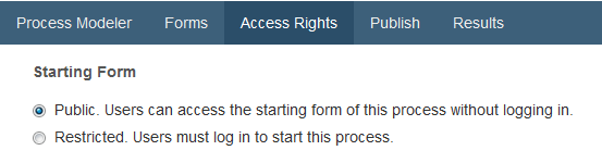

The license itself seems fine. Can you clarify how you're determining that the Forms Portal feature isn't working correctly on that Forms Server? Is it that when you view the Access Rights of a particular business process, you don't see the "Public" option as pictured below?
replied on October 29, 2014
That's completely my error.  Forms wasn't loading on the other server, and I had mistakenly thought it would show up under Publish (specifying how the form would be published).
