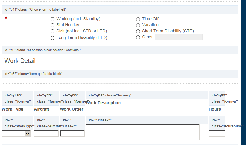

I want to make a require column field in a table with java when the radio button "Working" is selected. here my forms
So I want to make the worktype column a requirefield. I tried this script I got the " * " appear but the field is not realy a require field because I can submit the form witout field any data in the worktype field

Use the CSS Class of the input field, not the overall field.
$('.WorkType input').attr('required','True');
// For Making it not required
$('.WorkType input').attr('required'.'False');
You are targeting the entire field with the #q166 code, but you need to target the input field precisely, which is like its own entity inside another entity. It's easier to give that entity a CSS Class and program it directly.
One last thing, I am not 100% sure this code will work for the repeatable rows of the form. Might need to use a loop iterating through each row and applying that code to the "this" inside the loop
replied on October 28, 2014
I always have trouble referencing table columns by those IDs like you've shown... I've found it's better to add a CSS class and use that to select things in a table. It looks like you have a CSS Class associated with the field already, "WorkType", so then the only other problem would be that it's a dropdown element and not a single line field. You'll have to adjust the selector a little bit:
$('.WorkType select').attr('required','True');

Yes in my table I use drop down list so the select is the good one and both of you help me a lot on this
