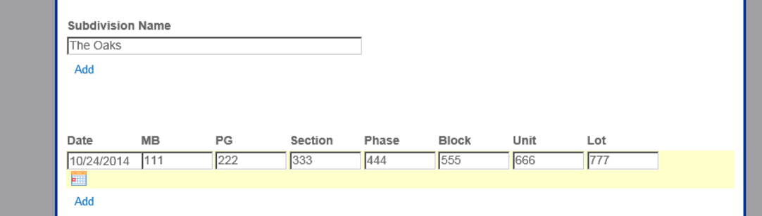

In Workflow 9.1 I'm collecting data from a Laserfiche form and using it to populate an Adobe PDF Form.  In one of the area's of the PDF Form I'm using the Apply Index token editor in Workflowr to grab the correct values and apply them to the correct field on the PDF.  I'm having an issue where in a table on the Laserfiche form only 1 row of data is submitted, however all of the fields in the table of the PDF are being populated and ignoring the assigned index from the token editor.  I read in the notes of Workflow the following, which I believe is the cause of my issue:
"Note: If you are counting values from the start and you specify an index greater than the total number of values in the token, the token will be replaced by the last value. If you are counting values from the end and you specify an index greater than the total number of values in the token, the token will be replaced by the first value.
Is there a way around this issue or a way to disable it so that the LF Form submitted values are not repeated?

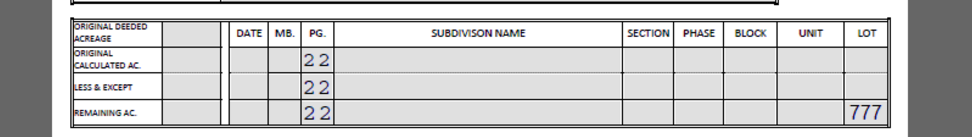

Miruna,
Thanks for your reply.  I'm seeing strange results when using the Table feature.  Some fields won't populate at all, while others will populate the wrong field in the table.  Are their any known compatibility issues with any version of adobe?  Any other settings I should check?  I've provided additional screenshots for reference.
Thanks!

I've discovered my issue.  In the Fill Out PDF Fields activity there are two tabs; Individual and Table.  For this activity, they cannot be used in combination; you must use one or the other.  By clearing out all items in the Individual tab I was able to successfully use the Table tab and fill out fields properly as Miruna described.

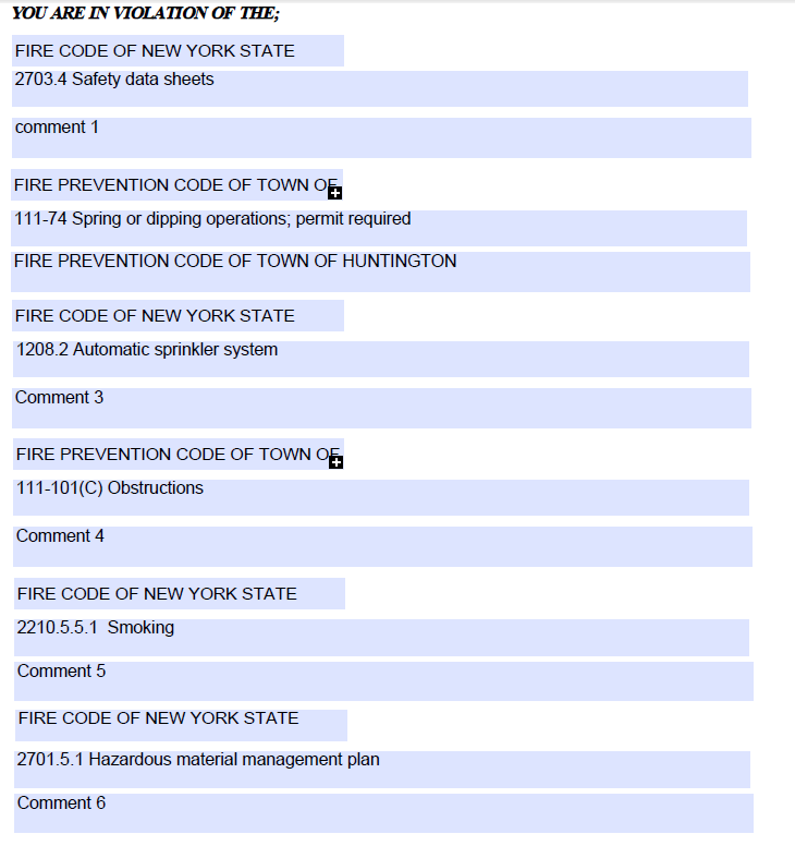

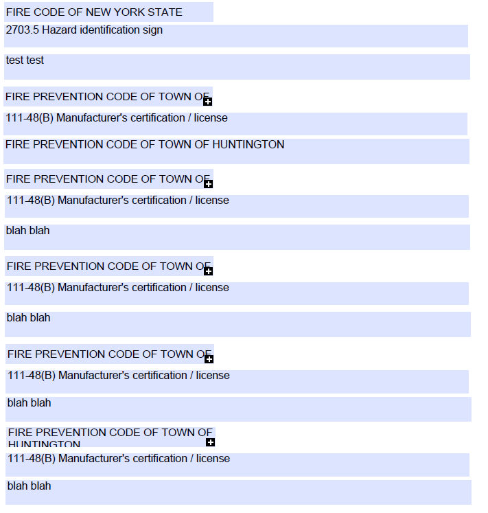

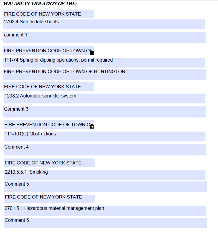

I am having a similar problem but am using a collection instead of a table.  (The data being recorded is lengthy so a table wouldn't be practical).  To populate the PDF form with workflow I'm using %(Getformdata_CodeBook_All#[1]#), %(Getformdata_CodeBook_All#[2]#), %(Getformdata_CodeBook_All#[3]#) and so on.  The form will accommodate up to 6 codebooks.  If I fill out all 6 the PDF populates correctly but if I only fill out 3 codebooks the last 3 fields populate with the value in the 3rd field.  Is there any way to fix this?  Thanks Sandy  See the attached examples

Attached are both the editable version and the form version that will allow for the PDF to be edited and saved.

Indexing multi-value tokens past the last value returns the last value as you've noticed.
Based on the PDF, you should be able to use the table feature to fill in Codebook/Comment/LongDescription fields. The layout doesn't matter, "table" fields are detected by regular expression based on their names. Something like "Codebook(\d?)" will find all 6 "Codebook" fields on the page.
replied on April 28, 2015
That worked Miruna, thanks!
