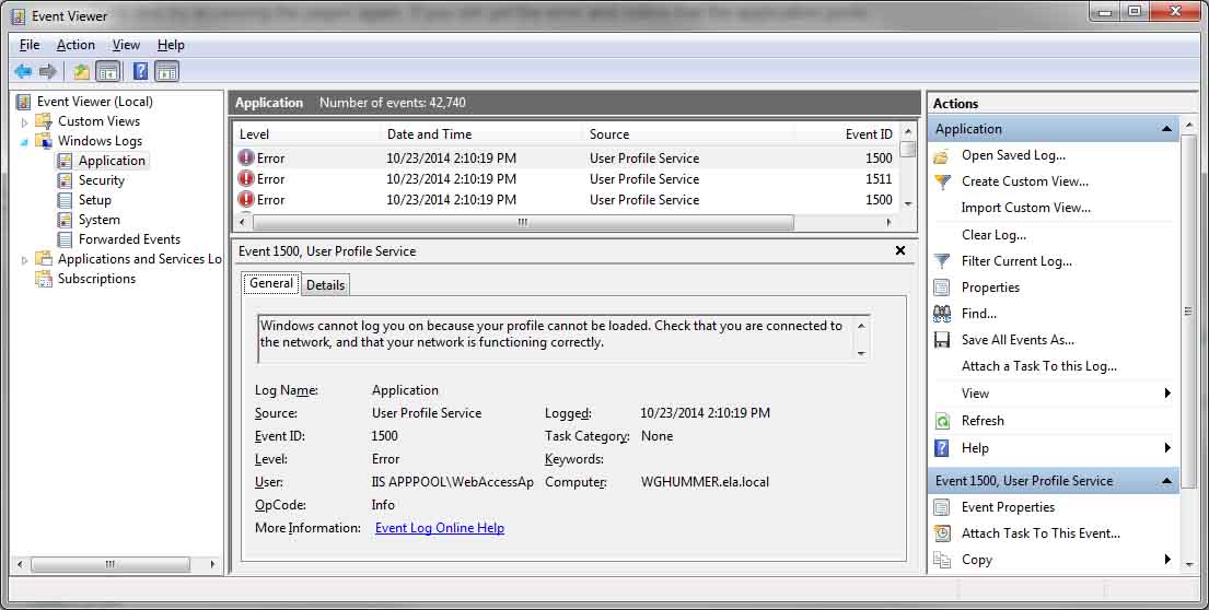

Yes, I started them from the IIS Manager and they stop after I attempt to launch both configuration pages.
Probably worth noting is that there is another application pool called DefaultAppPool on my machine that stops when I attempt to launch either configuration page.
The application event log says:
"Windows cannot log you on because your profile cannot be loaded. Check that you are connected to the network, and that your network is functioning correctly.
 DETAIL - The system cannot find the file specified."
Screen shot attached

replied on October 23, 2014
Thanks that worked for both. The Identity on my machine was called "ApplicationPoolIdentity" I changed their identity to the same one that the "WorkflowWebServicesAppPool" was using and both configuration pages loaded fine. Thanks again for your help.
