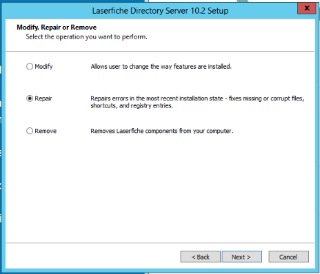

replied on September 29, 2017 • Show version history
I had the same issue, I went into the Directory Server 10.2 Installation in Autorun.exe as i was told to uninstall and reinstall by TectSupport after every avenue was tried.
I hit repair instead of uninstalling it and this resolved the issue for me.
Just something to try if all else fails :)
