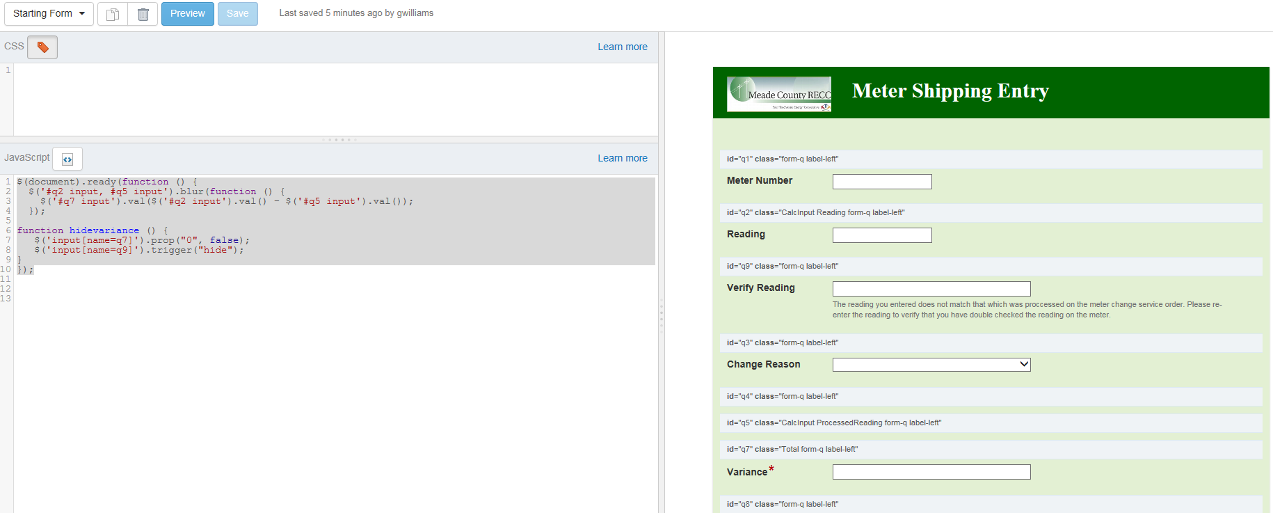

I am attempting to hide a field based on a javascript calculation. Basically what i am trying to do is hide the "Verify Reading" field if the "variance" field is = 0.  This is a calculated field that is the difference between the user inputted "Reading" field and the look up value being populated in the currently hidden "CalcInput" field.  After reading Scott's post, I am trying the code below without any luck.  My calculation from lines 1-4 work fine but I am not familiar enough with javascript at this point to troubleshoot what changes need to be made.  Any help would be greatly appreciated.
  $('#q2 input, #q5 input').blur(function () {
    $('#q7 input').val($('#q2 input').val() - $('#q5 input').val());
function hidevariance () {
   $('input[name=q7]').prop("0", false);
   $('input[name=q9]').trigger("hide");
replied on December 18, 2014
Configure your field rule to hide the "Verify Reading" field when "Variance" is equal to 0. Then in the JavaScript section, use the following:
    $('#q7 input').trigger("change");
Thank you Alexander, worked perfectly!
