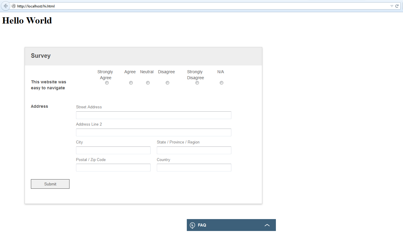

You could play around with it to change the positioning and also use pixels instead of percentage. Here are some before and after screenshots that shows the effect of the changes

I have changed the height to 100% and tried 90%, but it still looks like the first screenshot you took. To make sure it's not our CMS that is causing the issue, I created an empty HTML page and put the code in there and I get the same result. Any ideas?
