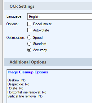

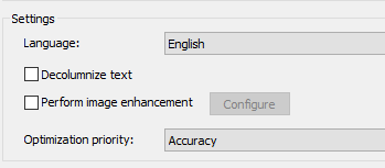

I'm hoping someone can shed some light on this. I have a customer that has noticed he is getting slightly different OCR results when using the scheduled OCR in Workflow vs the Client. The settings for the OCR are identical. Is the Workflow using a different OCR engine vs the Client using OmniPage 18.5?
I will attach some screenshots.

From the looks of the screenshots however both of the settings look identical. The OCR'd text from Distributed Client almost looks like one of the settings is not on. You might try removing one thing at a time from your client and see if you can get close to the same results. There might be an image enhancement that is not actually kicking in.

Thanks for the replies, the problem is we don't want to mimic the results from Workflow, we want to mimic the results the client can achieve but in Workflow. So basically, workflow isn't doing something that the client is. The problem is, there are no other settings possible in the Workflow configuration as shown in the screenshots.

Are the OCR settings (optimization, image enhancements) the same in the Schedule OCR activity and the Client?

Shaun, I'm not seeing any screenshots in this thread. Schedule OCR provides the same options as the Client in Workflow 9.1.
replied on October 16, 2014
Miruna: there were screenshots here earlier, I downloaded and looked at them.
Shaun: I'm not proposing changing the settings to match workflow because obviously that was way worse. I was suggesting changing the settings in the client to see if you can duplicate it so you have a better idea what's happening. That way if you do you can either post those results here and/or open up a case with support. Obviously distributed processing is handling something different. Looking at the output from earlier when I downloaded it (before it was deleted, it was still in my downloads folder) it looks to me like decolumnize is on even though it says it's not.

Thanks Chris, Miruna. Yes I had uploaded the screenshots, someone must have deleted them as they are not on here anymore. Chris, I asked my client to do the exact same thing you asked, as I too was wanting to see if it could be replicated, but haven't received results yet.
