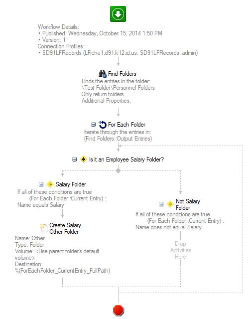

We have an employee's folder structure as follows:
  • Personnel Folders
    • A
      • LastName, FirstName - 1234
        • Salary
    • B
    • etc.
I need to add an "Other" folder to each Salary folder within an employee's folder. I have a Workflow that I thought would work, but it seems to only be searching through the folders within the Personnel Folders and not any of the subfolders. Below is a screenshot of the current Workflow:
How do I get it to search through all of the subfolders of Personnel folders?

Instead of using the "Find Entries" activity (which you named Find Folders), you can use a "Search Repository" activity and the search query would look like
{LF:Name="Salary", Type="F"} & {LF:LOOKIN="RepositoryName\Test Folder\Personnel Folders"}
Then you can also avoid the conditional check if it's a salary folder or not.
replied on October 15, 2014
How could you specify the advanced search syntax to find all "Other" folders that do not reside in a folder named "Salary"?
replied on October 15, 2014 Show version history
Will you still be only looking inside the Personnel Folders branch? If so, then the search syntax would be
{LF:Name="Other", Type="F"} & {LF:LOOKIN="RepositoryName\Test Folder\Personnel Folders"} - {LF:ParentName="Salary"}
Side note: as of Workflow 9.1, Create Entry has an option to return the existing entry if it finds one. So you can just replace your routing decision with just a Create Entry activity.
