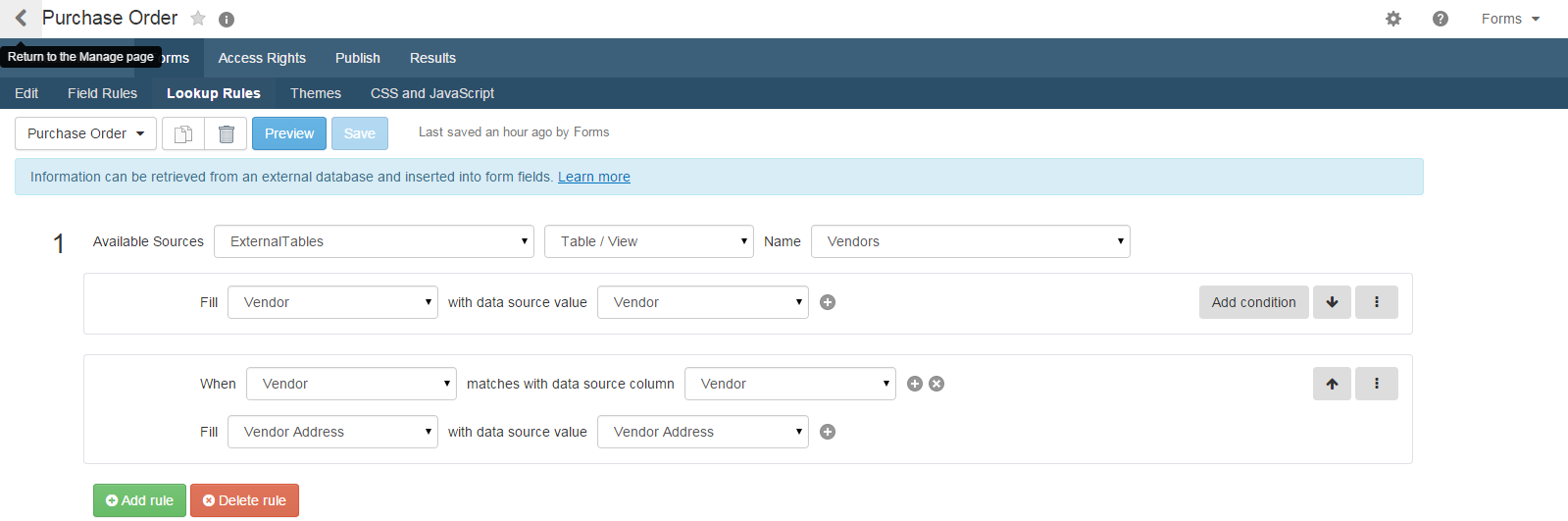

I therefore created a new lookup on the form to unconditionally fill the Vendor field with the Vendor column of the Vendors field, i.e. the lookup has no condition element.
However, when I run the form the vendor field is not populated with the contents of the ExternalTables Vendors table.

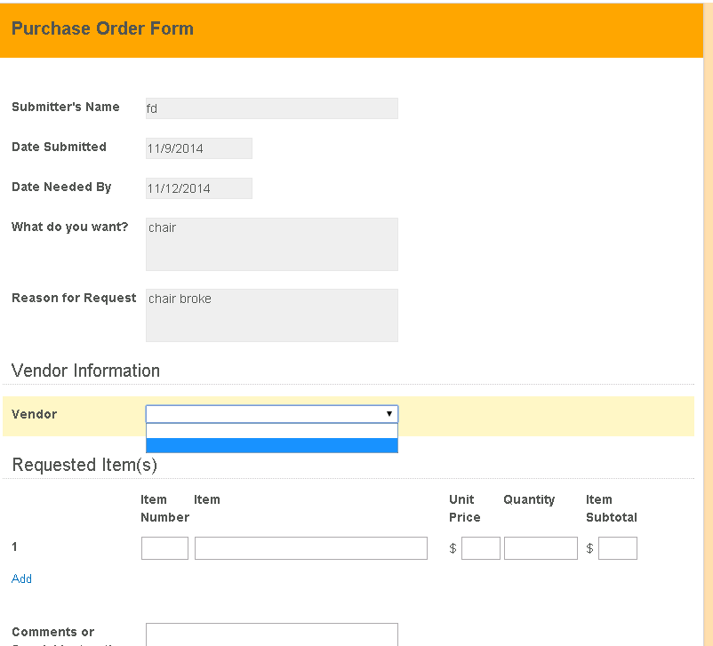

The same thing happens to me. I've check sql studio to make sure the table exists.
below is the error we are referring too.
please assist =)

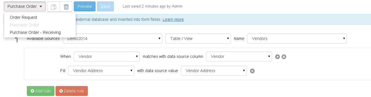

In case anyone still need the answer, this is what you need to setup in the Lookup Rules.
