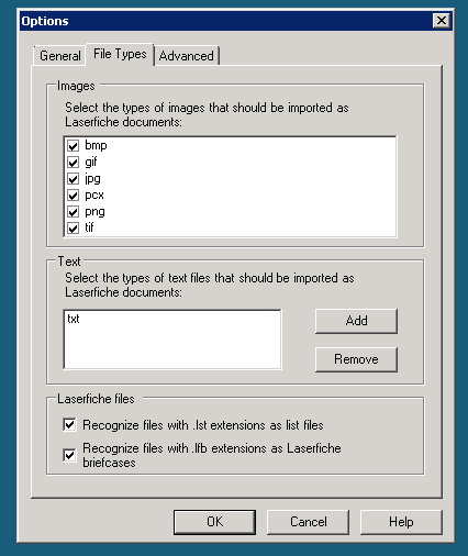

I realize that this might be stating the obvious, but have you made sure that tif is checked as a valid import file type?
