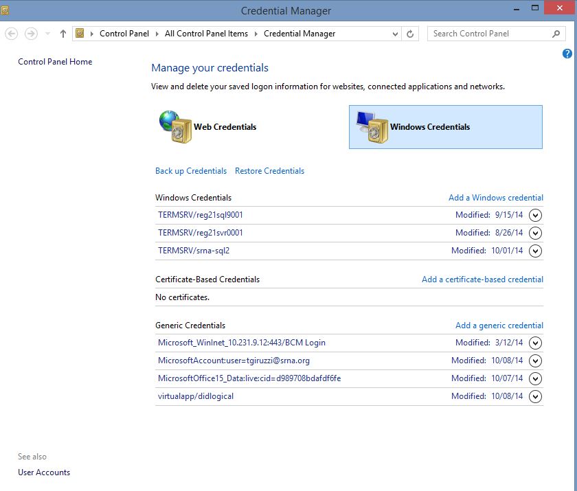

It may be a stuck or outdated credential saved in that persons user profile. Log on as the affected user, go to control panel, Credential Manager (see attached) and delete any credentials related to Laserfiche or scanning (if in there).  Reboot again and let me know if it worked or not.
replied on October 10, 2014
Checking now!  We had an issue with Active Directory previously so there was one spot we already checked for "hung" passwords - this is a new one so we'll find out!!
