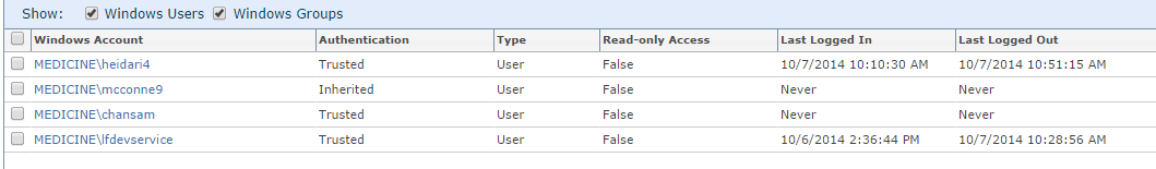

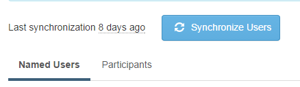

Hi there:
We recently configured Laserfiche to use Active Directory for authentication in addition to the native Laserfiche authentication.  We can see the 5 Active Directory users we've added as a test in the Laserfiche webadmin console (see attached picture)
When we go over to forms though, we are only seeing one of the AD users, who happens to be an AD admin (not sure if that makes a difference).  Moreover, it doesn't look like synchronization is occurring since according to the system the last  synchronization happened 8 days ago (when it was originally set up).  We've tried multiple time to synchronize, but it doesn't seem to work.

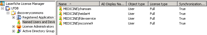

replied on October 7, 2014
In your Rio environment, can you confirm that the Windows accounts are added under the Named Users and Devices node in the License Manager Administration Console?
Also, when you tried synchronizing users and noticed that the "Last synchronization" wasn't updated, were there any error messages recorded in the application event log on the Forms server?
replied on October 8, 2014
Hi there - yes we did confirm the Windows accounts are added under Named Users and Devices (see attached image).  I'll have our sys admin check the event logs for the Forms server
