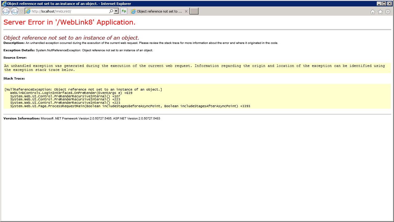

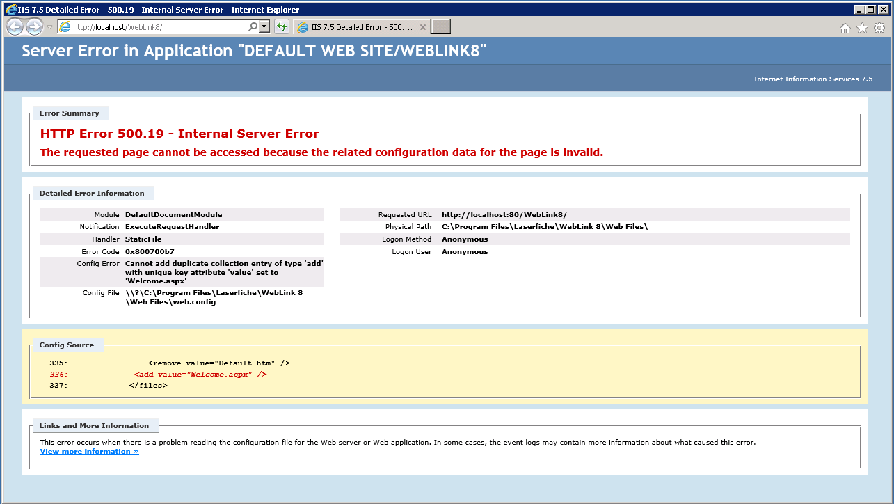

When trying to access the http://<servername>/weblink8/ link I receive an HTTP error 500.19. The error points to a duplicate instance of adding the Welcome.aspx page to the default documents(located in the web.config for Weblink, see screen shot). Upon removing this entry from the web.config I receive an "Object reference not set to an instance of an object" error when trying to load the page(see screen shot). Trying to access http://<servername>/weblink8/login.aspx or http://<servername>/weblink8/welcome.aspx results in the same error.

I feel as I might not be explaining the situation correctly.
I tried to access the "http://<servername>/weblink8/" link, I received an HTTP error 500.19 - 0x800700b7 in Internet Explorer.
The error points to a duplicate instance of "<add value="Welcome.aspx" />". This is being set elsewhere in IIS so the entry which is located in the web.config for Weblink is unnecessary. See screen shot in the intial post.
I edited the web.config in the "C:\Program Files\Laserfiche\WebLink 8\Web Files" folder. I commented out the line "<add value="Welcome.aspx" />" which is located under <defaultDocument>.
I saved the changes to the web.config file.
After making the changes I tried loading the "http://<servername>/weblink8/" page again. Now I receive "Object reference not set to an instance of an object" error when trying to load the page(see screen shot in initial post). Trying to access "http://<servername>/weblink8/login.aspx" or "http://<servername>/weblink8/welcome.aspx" results in the same error.
