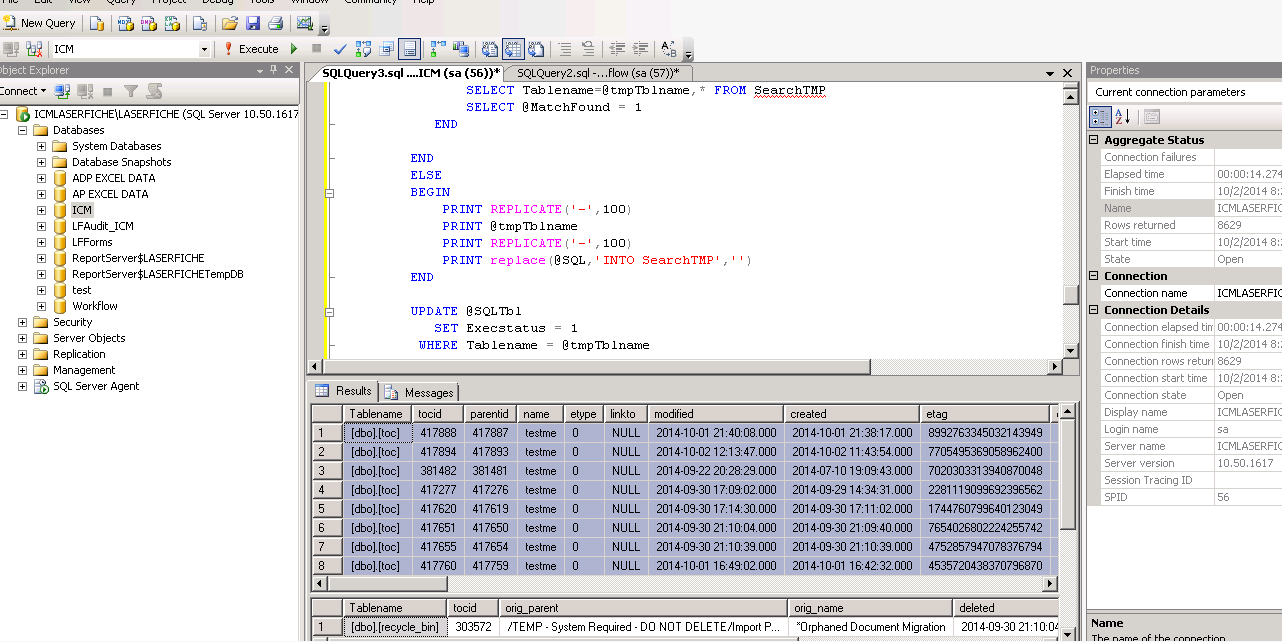

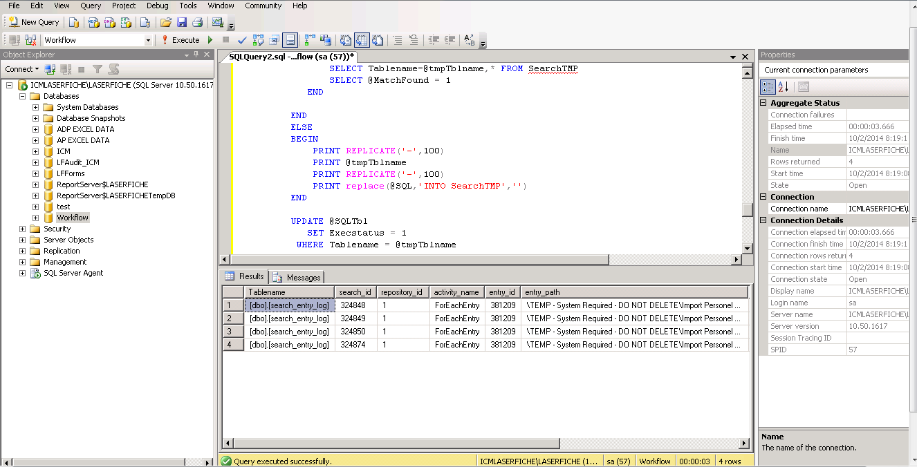

  1. Ran DBCC integrity checks on the Laserfiche  Workflow database, and Laserfiche Repository database. No errors generated
  2. Ran the attached script (SP_SEARCHTABLE.SQL.TXT on the Laserfiche  Workflow database, and Laserfiche Repository database. Found references to the “testme” folder in both. (See attached CSV files and screen captures)
