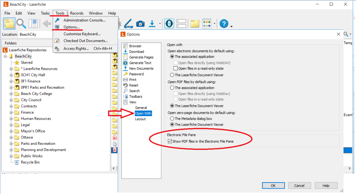

Fixed! Here is how:
Go to your LF, and navigate to Tools/Options.../View/Open With
No make sure that the answer to "Open PDF files by default using:"
is either "the laserfiche document viewer" or "the associated application"-"open files in a read-only state"
The second option might mess with ability to edit pdfs.

With the Window Client, if this setting " Show PDF in the electronic file pane" is not selected you will get the error message "unable to display the electronic file type for this document".
