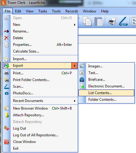

  2. Do you export the list of contents from a search?
You could save a search profile on the client to run at certain times (monthly, quarterly). The records management module uses the client search to tell us when documents are eligible for destruction.

Thanks for the responses. My idea was actually to export list contents from a search and identify a lot of errors from there, so thank you, Chris, that's what I was thinking. I set up the column structure for each template type that we have so that I can run a search for Governance documents, apply the column structure for governance docs and export the list contents and analyze them through Excel - LOVE this feature and I use it a lot.
This will allow me to identify any missing fields, any mismatched metadata. We do use dynamic fields, but they've gone through revisions over the years so that's where we get mismatches. This will also help me identify where we may be missing files, if we have no files of a certain type for 2007, but we have a lot for 2003 - 2014. The only thing that this will not be able to do is check for bad scans, verify that it is the document it says it is, that it has no missing or extra pages, or anything else that requires a real live person to look at the document.
