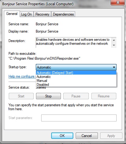

You may try changing the service to have a delayed start. It may be having an issue at startup that is not allowing it to start completely.

The Delayed Start Option seemed to fix it. Life is Good.
replied on November 14, 2014
The Automatic(Delayed Start) fixed it.   Life Is Good.
