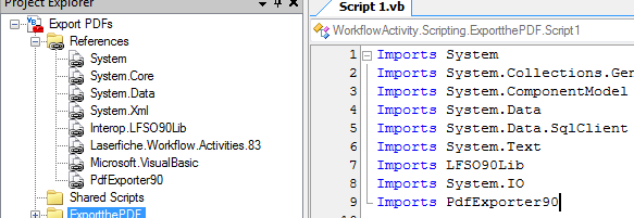

Part II - This uses the same example as above, and replaces Document Processor with the PDFExporter.
First, add a reference to the dll and then import it:
Then the code looks like this:
