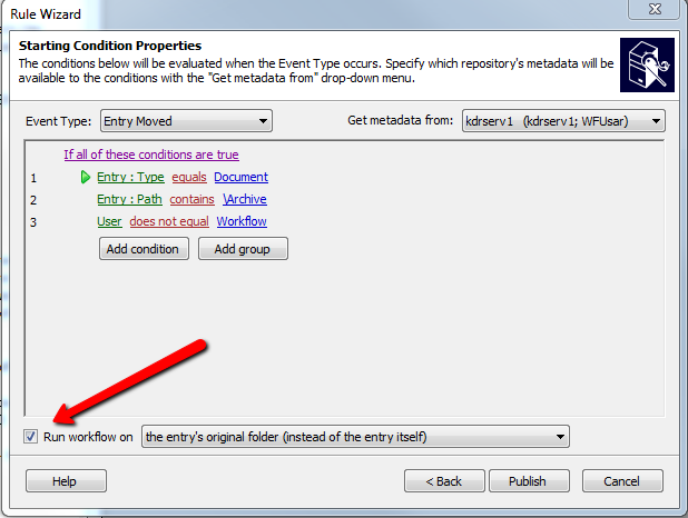

replied on September 19, 2014
Check on your starting rules and make sure you don't have the box checked which says "Run workflow on" and then "the entry's original folder" because that would certainly cause the behavior you're describing.
Definitely don't have that checked on.

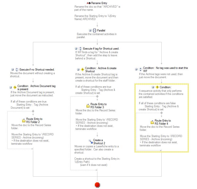

replied on September 25, 2014
UPDATE!  We discovered there was a problem with the Workflow user password in the "Manage workflow connection profiles".  That's all that was stopping the WF.  Here is my most current, and WORKING! :) design...
And starting rules...
