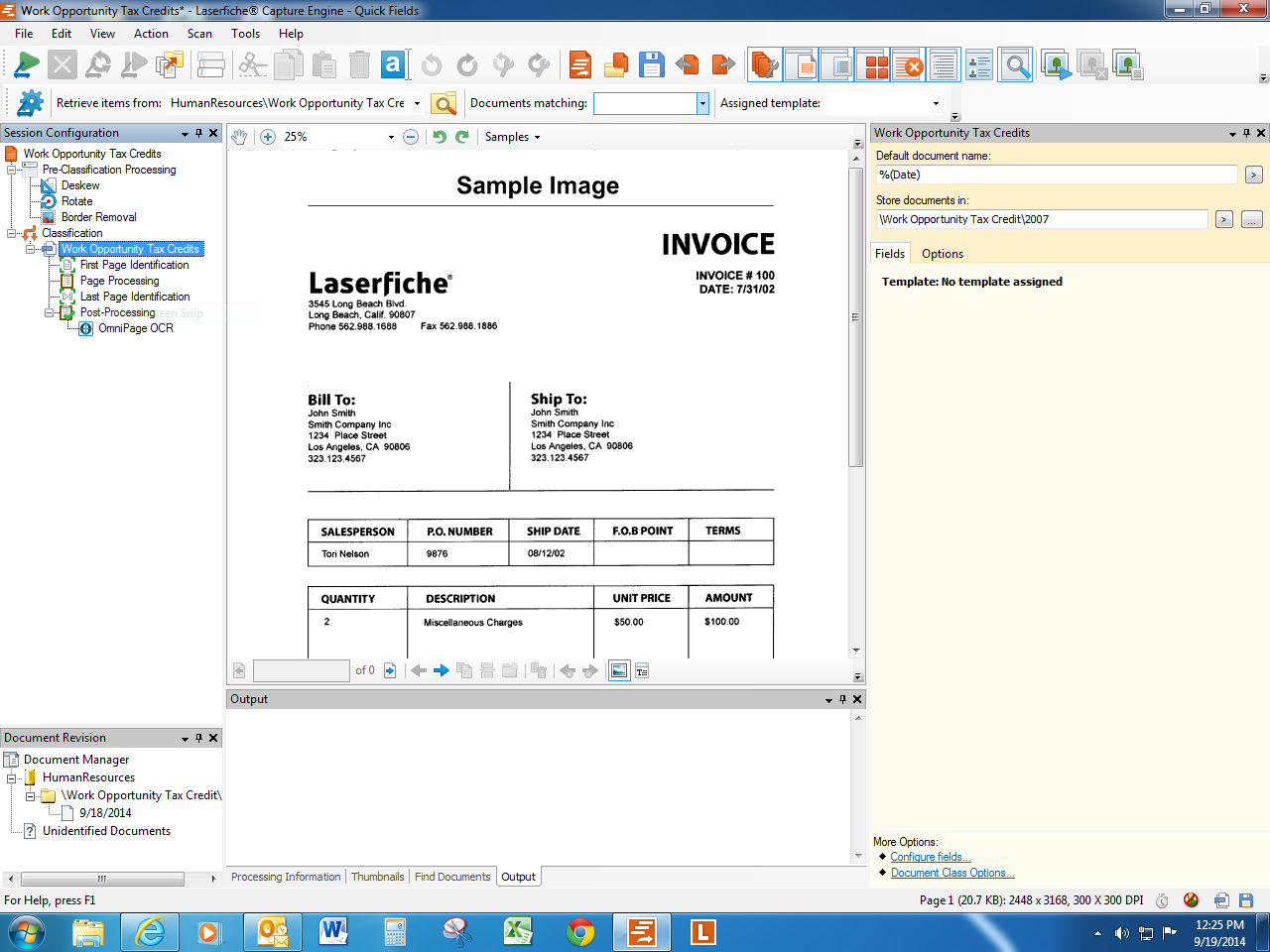

Please see attached.  I set my pages to be sent to the repository this past Friday evening.  When I came into work Monday, my document was still sitting in QF 9.  It doesn't show in this picture (revision pane)  because I went ahead and sent in back to the client.  Why didn't it stored?  What should I check?  Any input would be appreciated.

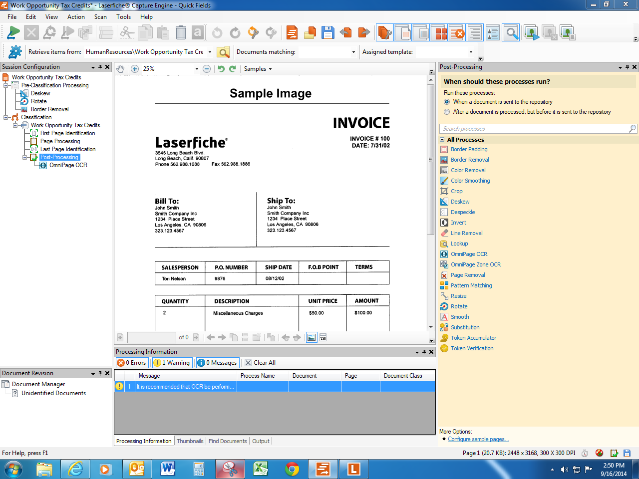

Also, you should be setting the OCR on the "Post-Processing" stage if you want it to OCR each page as it sends it to the repository. Doing it inside Page Processing only makes it available as a token to use with other activities while you are processing/capturing the documents and trying to assign tokens and metadata to a document based off its contents.

Looking at the help documentation, you will just have needed administrative rights to allow the service task to be created for this process. The Quick Fields session though should have "Omnipage OCR" in the "Post-Processing" stage and have the option "When a document is sent to the repository" as it's option for running those activities. (that should be the default option, so do not fear if you do not see it right away)
replied on September 16, 2014
Oh, okay.  So, I moved the OCR process to the post processing stage.  Now, this process should take place when it is sent to the repository as shown?  And. . . leave QF open?  Correct.  Any step I'm missing out on?

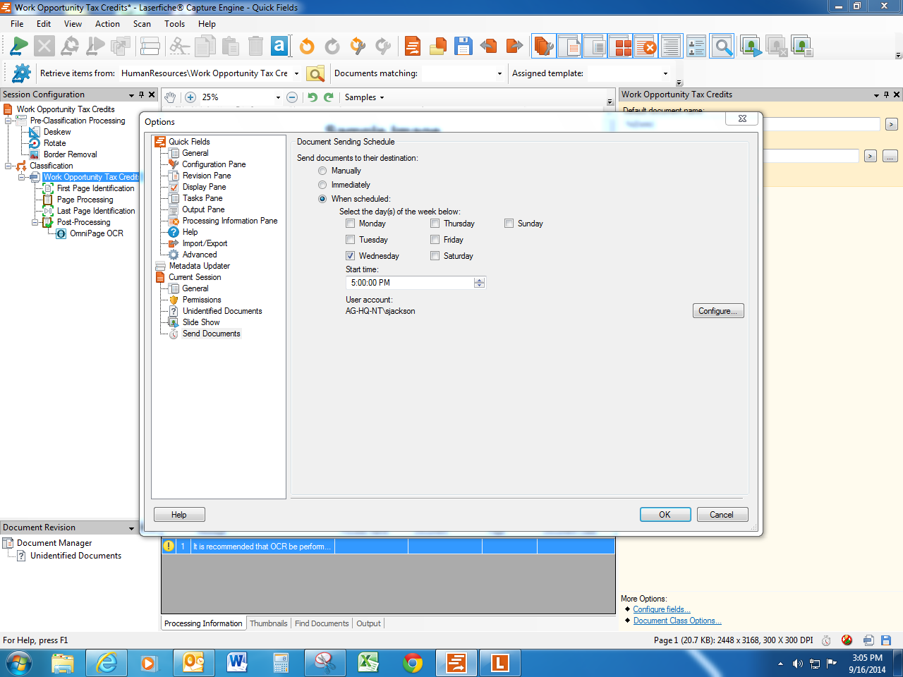

If you set up a schedule for sending documents, Quick Fields needs to be closed (or at least not have the session loaded) when the schedule is expected to run.
I do have administrative rights in Quick Fields--not LF--at this time. Service task?  Is there where I set up the User Account:  configure?

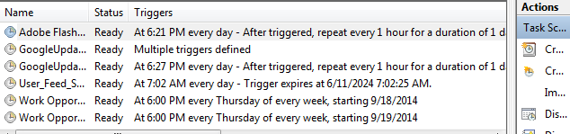

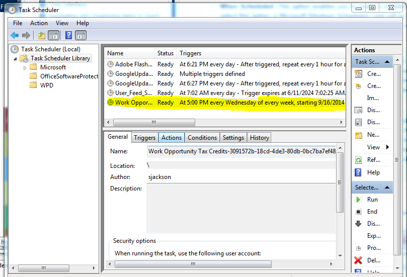

Go into the Windows Task Scheduler Library and confirm that there is an item present for your Quick Fields session. If it is present, check what the last run time and last run result is listed as. If it is not present, then there was an error creating the scheduled task in the first place. You may need to make sure that the Windows account you're using as administrative rights to create scheduled tasks in Windows.
Also, from the screenshot, it doesn't appear that there were any documents to be stored back into the repository.

Attached is the schedule I just created.  There wasn't one there from last Friday. Now, do I load the document(s) into QF 9 to process and leave QF open?
1.  Scan documents into QF with LF Capture.
2.  Leave  QF 9 open and let the "When schedule" do the rest like   OCR and will send docs back to LF repository?
Is this correct?  Seems I have to at least "scan" the documents into QF 9.  Then, save session.  Leave open or close it?

After you scan the documents into Quick Fields, they should be sitting in the Document Revision pane. You can just close Quick Fields at this point as the documents will remain in the temp Windows location until they get stored.
When the scheduled time arrives, the documents will get OCR'ed as they are being stored into the repository.

replied on September 19, 2014
Hello Alexander,  NOT! I think.  I'm sending a few snip its to show you. Sending in two parts.  Can't seem to attach too many at one time.
Looks like it is still "running".  Reminder, I have never done this before.  I am teaching myself everything.
Any input would be appreciated.  Sending a couple pics with this reply and will reply and again with more.

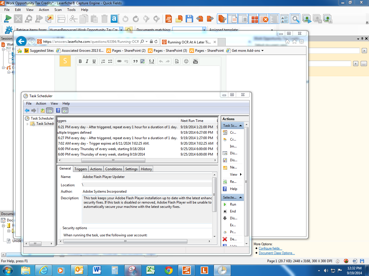

Alexander,
Pics of my set ups.

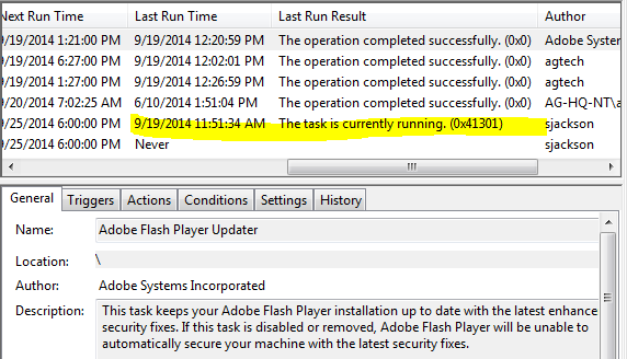

Alexander, any input would be appreciated.  What am I doing wrong?
APPROVED ANSWER
It's unclear as to why the scheduled task is still running as it looks like there was only one document it had to store.
At this point, it would be best to contact your Laserfiche reseller to open a support case so that we can investigate the matter further.
