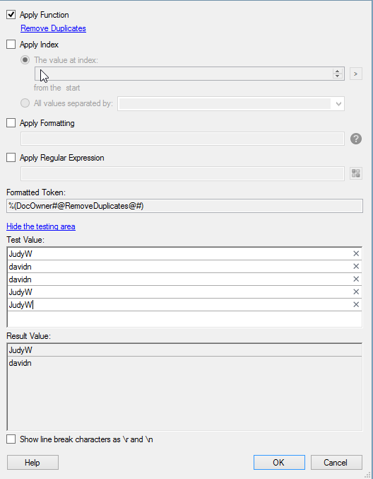

What version of Workflow are you using? You can apply a function to the token and remove duplicates.

well, if you have a token with all the values and you apply the function to remove duplicates, then you wouldn't need to loop through the token when creating the multi-value token, you would already have the output you were looking for in the end.
