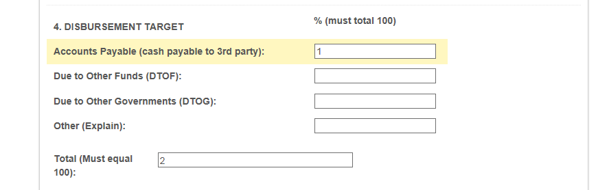

replied on September 16, 2014
That works great.  Thanks, Eric!
replied on September 8, 2015
Eric,
When I tried using your javacode provided, everytime I add a number it does a multiplication instead of addition.  Is there anything I should look for to prevent this?
    $(document).on('blur change', '.sum2 input', sumtotal);
	function sumtotal() {
	    var s = 0;
		$('.sum2 input').each(function () {
		    s += parseNumber($(this).val());
		$('.total2 input').val(s);
	function parseNumber(n) {
	    var f = parseFloat(n); //Convert to float number.
		return isNaN(f) ? 0 : f; //treat invalid input as 0;
Try the suggestion from this thread. Instead of
use
$('.sum2 input').filter(':visible').each(function () {
replied on September 9, 2015
Thanks Alex,
I wasn't aware that IE11 handles this java code differently vs other browsers or older version of IEs.
