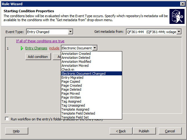

replied on September 12, 2014
It's not possible to query the reason before starting the workflow. However, you could have the workflow start from an entry changed event that includes changing the electronic document.
You'd need to add more conditions, like the document extension being PDF, or the folder path and such to make sure it only starts on the documents you want.
Then in the workflow definition, you could run Verify PDF Signature to get the signing reason and route the document accordingly.

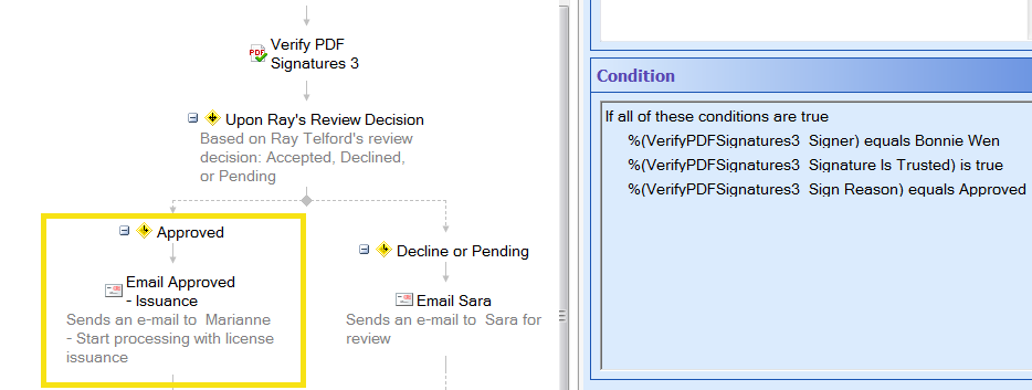

replied on December 5, 2014 • Show version history
Hello Miruna,
Thank you for your reply. I have redesigned my workflow with Verify PDF Signature. I used token to query Verify PDF Signature - Sign Reason, but still could not use the Sign Reason to trigger workflow. Still everything goes to the decline/pending branch. I cannot upload .wfl file here. Can I email the workflow to you, so you can help me take a closer look? Thanks!
Unfortunately, no, we cannot provide direct support through this forum. You can have your reseller open a support case if necessary.
Have you checked the instance details, specifically the Conditions tab? It should tell you exactly how the conditions were evaluated.
