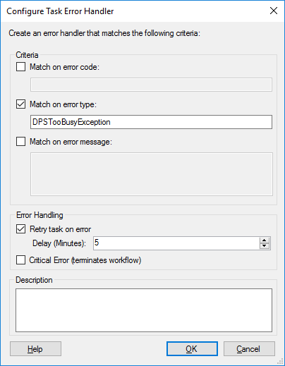

How long WF waits before retrying to assign the task to DCC and how many times is controlled by the Task Error Handlers in the WF Admin Console (under Server Configuration). Look for the "DPSTooBusyException" and switch it from "retry" to "critical". Next time an instance tries to schedule a task and hits that error, it will terminate the workflow. That might take care of your stuck instances without you having to do anything else. You can re-enable it later.

I've tried the "terminate workflows" option and that is what is taking 30-45 seconds a piece to terminate.  I'm still letting that method work but I've also changed "DPSTooBusyException" to critical per your suggestion.  I'd looked at those but wasn't sure which one to try it on.  Thanks a ton for the help and I'll post back in here if it works.

By default, the error is configured as a retryable error, so Workflow will attempt to send the work again.
If you're seeing it as a warning, that should be a sign Workflow's task error handlers worked.
