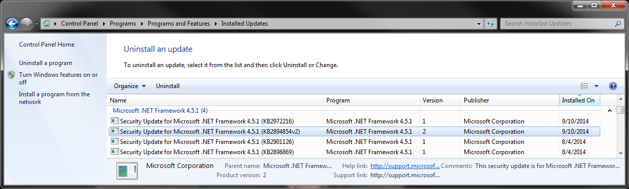

We saw the same results as Laura.  KB2894854v2 is causing the issue.  I first uninstalled KB2972216 and the problem remained.  After uninstalling KB2894854v2, the issue was resolved.  I then went back and reinstalled KB2972216 and issue remains resolved.

This fixed the problem. Would have been a wonderful notice to email out to people. FYI even if Version 2 is installed you can still get the error. We had Version 2 installed and could not get it fixed. We uninstalled both of the updates and everything works fine again.

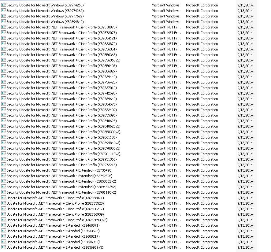

Hi Guys, our IT updated our web access server with the following updates, can someone help us isolate which one might have caused the issue. It is none of the ones mentioned above
I am attaching the screenshot of the updates.
We would like to see if we can restore service without the workaround since Laserfiche suggests not to disable the ViewStateCheck without ensuring we have safeguards against CSRF and Malicious Replay attacks.
Thank you for your help.
