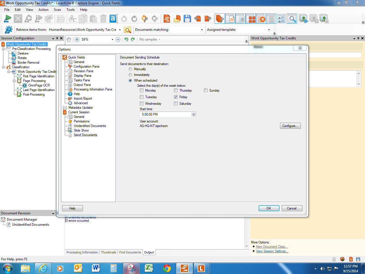

replied on September 15, 2014
Please see the attached. I set my pages to be sent to the repository this past Friday for 5:00 p.m.  When I came in today, my document was still sitting in Quick Fields.  It doesn't show here because I went ahead and stored it and I am presently performing OCR in LF.  Why didn't it store as I scheduled?  What should I check?  Any input on this would be much appreciated.
