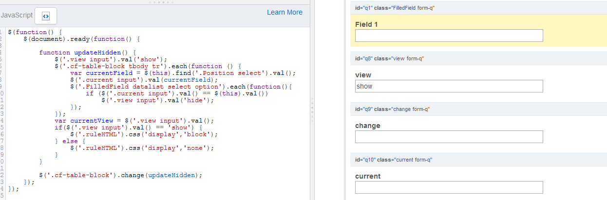

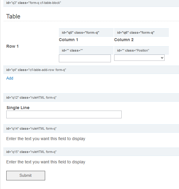

Here you go, this is fully working if you do it like this. Just add some CSS class and hide it to the fields I use to make it all clean. I use a view field, current field and Position set to the column in the table. I also use the CSS Class ruleHTML to control which fields hide. Lastly, I had a FilledField field with auto-suggestions listing all the options that should cause the fields to hide. I hope this helps:
$(function() {
	    function updateHidden() {
            $('.view input').val('show');
			$('.cf-table-block tbody tr').each(function () {
				var currentField = $(this).find('.Position select').val();
				$('.current input').val(currentField);
				$('.FilledField datalist select option').each(function(){
					if ($('.current input').val() == $(this).val())
						$('.view input').val('hide');
			var currentView = $('.view input').val();
            if($('.view input').val() == 'show') {
                $('.ruleHTML').css('display','block');
            } else {
                $('.ruleHTML').css('display','none');
		$('.cf-table-block').change(updateHidden);
