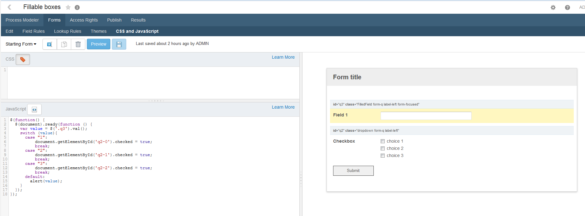

Kenneth,  I am looking to take a value from a stored procedure into a single text box  and then use the content of that text box (Value 1-5 but a single value) to select a check box in the form.  I have tried to get your first example to work as seen in the attached photo but am failing miserably.  Did I mention I have no understanding of Java and the data guy in me says it's just another variable why is this functionality not built into the system...
So if you can point out where I have messed up your code it would be great.
replied on September 11, 2014 • Show version history
You changed things to 'q' Change all those to 'Field'
Also, in line 3, you need to keep it how I recommended in the field place:
var value = $('.FilledField input').val();
Otherwise it is not getting the value from the field.
Last thing, you will need a value in that field, so set a default value for it as a test, or add a field that would represent the field that causes the lookup, at which point, you will want to assign that field a CSS Class name like "TriggerField" and then you would need to change the code to the below code snippet:
