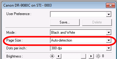

Assuming you're using the ISIS drivers, you should see it in the scanner settings under page size. Usually it is called "Auto Detect."
Here is a screenshot from our Canon scanner settings:

If the issue is that the settings aren't being saved properly, then that could mean the account that's logged into Windows doesn't have read/write/modify rights to C:\Windows\setscan.ini
