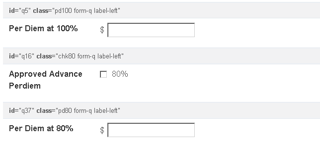

The check box is associated with a decimal value of 0.80.  When the user "checks" the check box, I would like to take 0.80 and multiply it with a floating point number that is entered in Field 1.  The result will then be stored in Field 2 upon the "checking" of the check box.  If the check box is not "checked", I want Field 2 to be hidden.
For some unknown reason, my code doesn't multiply the two values together after the check box checked.  Can anyone help?

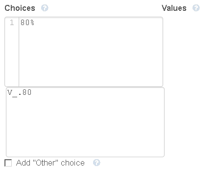

Attached are the images of the CSS_JS form field, and the check box properties, and the Java Script.  Here is the scenario, if the check box is "checked," I'd like to do a simply multiplication calculation between the "input value" of field 1 and the check box value; their product will be stored as the "input value" of field 2.  If the check box is not checked, the "input value" of field 2 should be set to "null."
