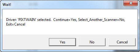

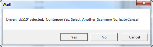

ScanConnect is an interface that allows our scanning software to work with a scanner's ISIS driver, not the TWAIN driver. If you are using ScanConnect, make sure that you have installed the scanner's ISIS driver and that it has been confirmed to work correctly. You can run C:\Windows\PIXTRAN\testappn.exe to first confirm that the scanner driver is installed and working correctly.
replied on September 2, 2014
I uninstalled the ISIS driver rebooted and then re installed it before trying this.
It looks like by running the testappn.exe I can confirm that "Driver: 'ds510' selected."

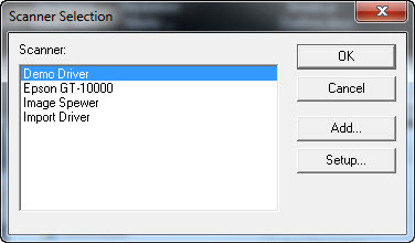

Or

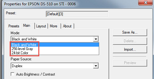

If I choose no at the prompt, it shows a "scanner selection" list. There are the following in the list:

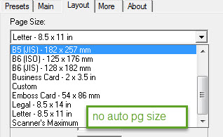

Nowhere in the ISIS drivers interface can I choose auto color or auto page size. I have to specify exactly what I want there.

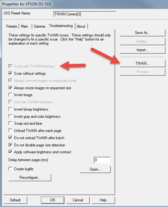

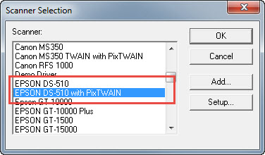

What I was referring to above where you can choose TWAIN through ISIS is this:
From Scan Source I choose ScanConnect.
From Scanner Selection I can choose between EPSON DS-510 or EPSON DS-510 with PixTWAIN:
If I choose the second choice, in Scanner Options there is a tab named Troubleshooting. It gives me the option to "Scan with TWAIN interface" and several other options:
By going this route, when I clicked the start scanning button, I was prompted with the TWAIN interface. I thought I had found a workaround there for a moment! ...but alas it did not work.

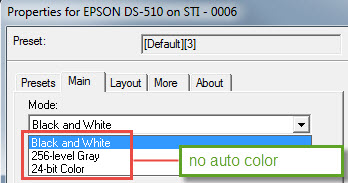

What about when you select the "Espon DS-510" scanner from the scanner selection box for ScanConnect? Are the options you're looking for not available in the scanner's ISIS driver?
replied on September 2, 2014 • Show version history
That is correct. These pics are from that selection and then going to Scanner Options.
Hope this helps
Thanks. It doesn't appear that Epson's ISIS driver supports those options. As for using their TWAIN driver and interacting directly with Epson's default scanner software to use their auto color detection and auto page size options, we'll update this thread after the teams at Laserfiche and Epson review the issue.
