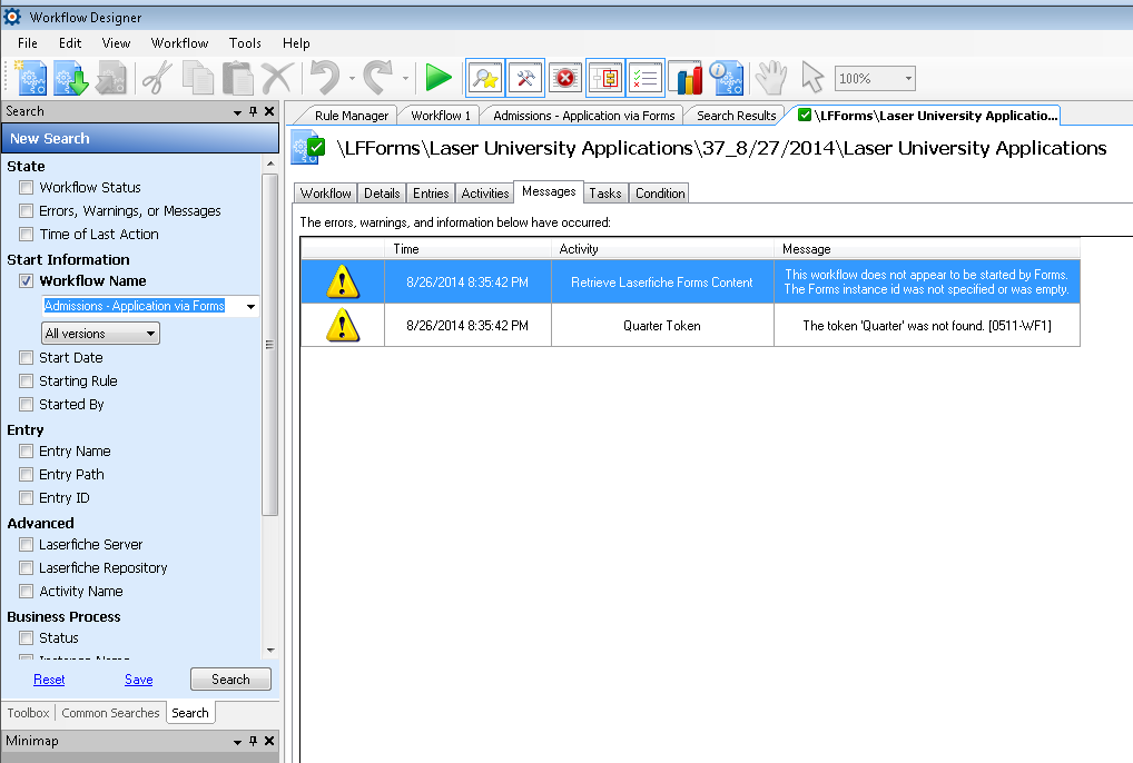

I'm working on the configuration of the Admissions VAR demo and I'm having an issue with the information submitted in the Form not being picked up by the associated workflow (Admissions - Application via Forms).  The form submits and the email notification is sent, however none of the form field information is collected by Workflow.  I've attached a screenshot of the messages from the results of the workflow.  Any guidance is greatly appreciated!

Rob,

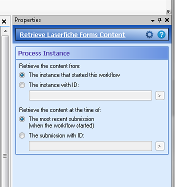

I've figured out the issue I was running into.  In the Publish tab of the Forms Process the item was selected to have the form saved to Laserfiche as a *.tif upon submission.  Then as a part of the workflow, the starting rule was to grab the submitted form (document) and retrieve the field content based on the submission and instance ID's.  Workflow was unable to get the submission ID or instance ID since it was being triggered by a starting rule and not Forms directly.
I was able to remedy this by adding to the process modeler a task to save the form to the repository step.  In doing this I was able to add the submission and instance ID's as field values to the submitted form.  As a part of this fix I unchecked the selection in the Publish tab of the form to store form as tif.  After doing so I am able to grab those values from the document that is created by submitting the form and then can call back to the Forms process to retrieve the field values for the workflow process.
