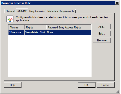

Do you have any security set on the business process rule in Workflow?
replied on August 25, 2014
No, there are no business process rules defined. They are initiated by other workflows.

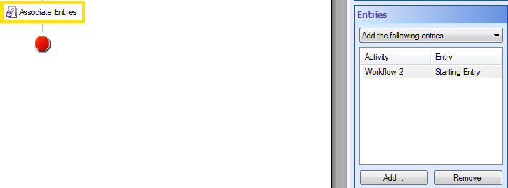

It's possible that the entry you're looking at isn't the starting entry, and thus may not have business process information tied to it even though it is a part of the business process. To test, please add the Associate Entries activity to your business process. When doing so, select the entry that you would like to have business process information displayed on. Please do so even if that is the starting entry, so that we can see the results of this.
replied on August 26, 2014
Hi Kelsey,
I added the Associate Entries activity to my simple test workflow and ran it against the same entry id I was using before. This time it showed that the business process was running but it also brought back the history of all of the other business processes that I had previously ran against this entry id that had not been visible before. I then removed the Associate Entries activity from my test work flow, ran it again and it still showed the business process information correctly in the client. Then I ran the same business process against another entry id and the results were displayed correctly as well.
It seems like the BP information was being collected the whole time but not showing up in the client until I added the Associate Entries activity to this test workflow. This is our development so I'm going to check to see if the same problem exists in our test and production environments. Do you know why adding the Associate Entries activity to one workflow would cause the results of all of the other workflows to suddenly appear in the client?
