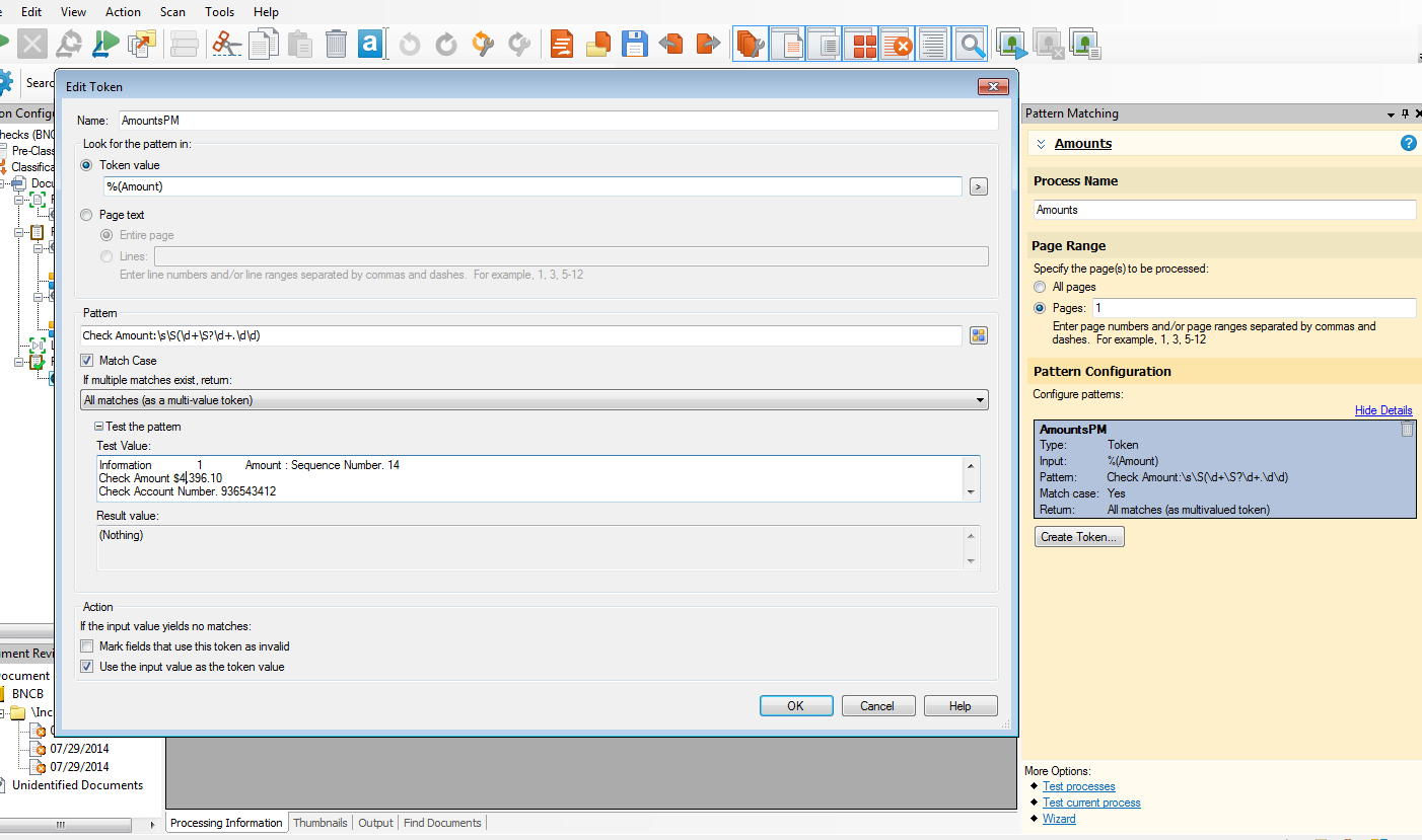

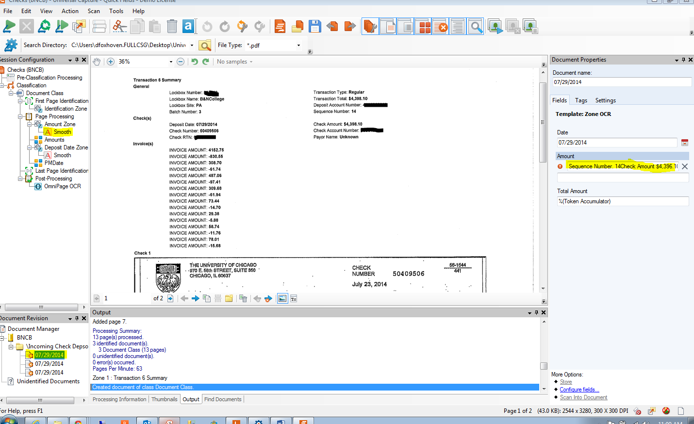

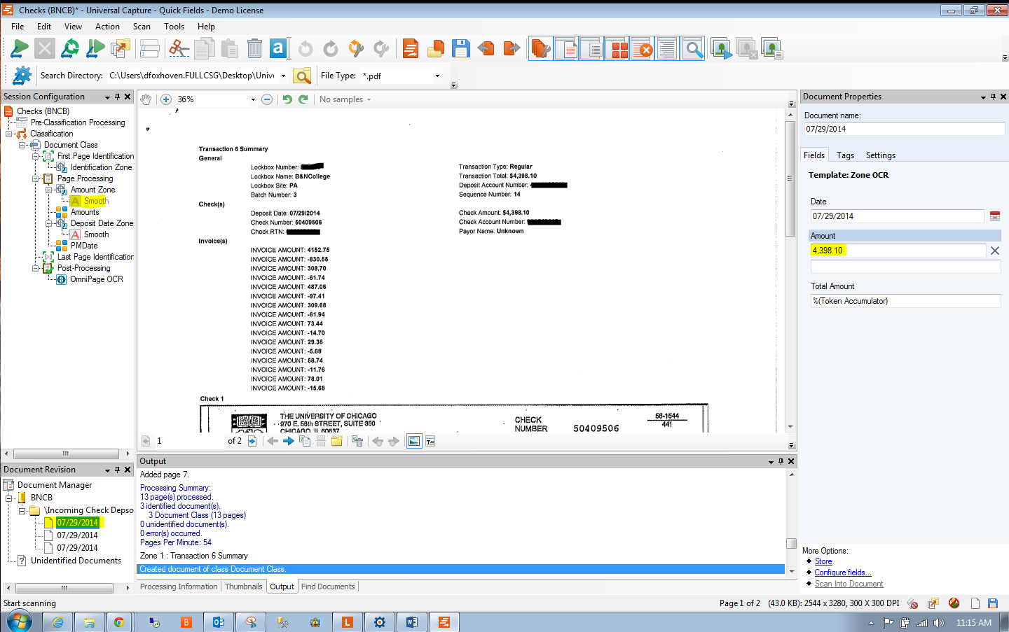

 So I'm using QF and Zone OCR to capture the amount from Checks.  I noticed that some of the check amounts were wrong due to quality...so I added the "Smooth" enhancement as a Local Enhancement to my Zone OCR, and it now messes up my Pattern Matching.  If I disable "smooth" the pattern matching works, but again, some of the amounts are wrong ($136 instead of $135, etc.).  If I enable it...it's like I'm not even using Pattern Matching.  See screenshots below.

The value you're putting in to test the process does not have a colon in it after "Check Amount". The regular expression, however, requires one.

There is not enough in your screenshots to guess what might be going wrong. But it looks like your pattern matching process is set to return the full value when it doesn't find a match.
Did you check the processing info pane to see what Zone OCR read and whether Pattern Matching found a match? What is your pattern set to?

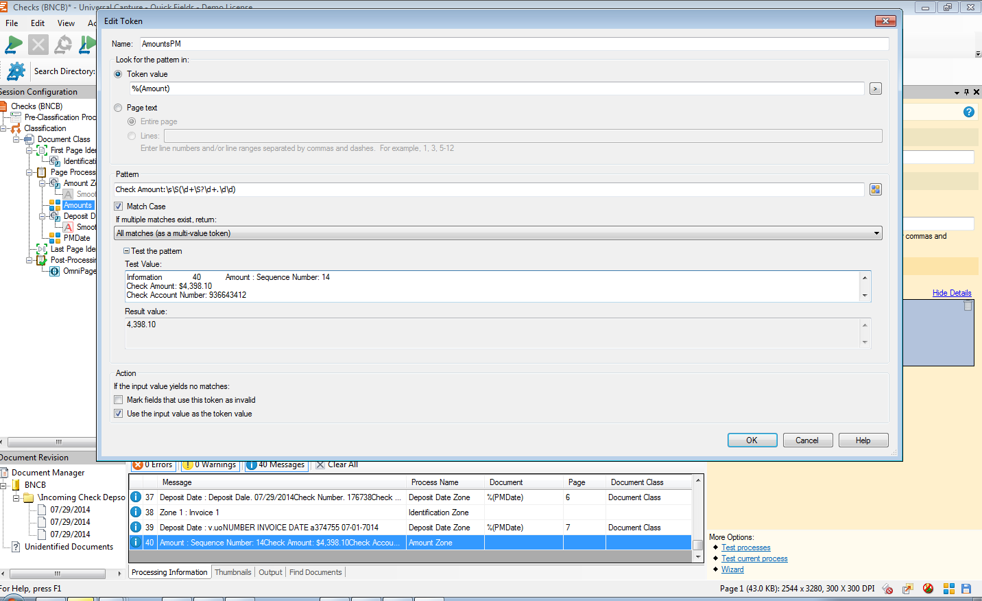

My Pattern Match works fine if the "Smooth" is disabled.  I've attached 2 screenshots of the PM properties and the resulting Zone Data.  One is with "Smooth" enabled (Amount is not found in PM), one is with "Smooth" disabled (Amount is captured in PM).  I'm a little confused.

Your first screenshot does not show the values that were read at processing time. In the second one, the processing info pane does not show the AmountsPM token value.

Miruna,
The first and second screenshot are from the same QF session so I didn't see a reason to show the AmountsPM token a second time.  As for the values that were read, those are the values that are in my "test value" window...I copied the values read and pasted them into that window.  You'll see that the first screenshot there is no resulting value (Smooth is enabled) and in the second screenshot the value is the correct dollar amount (Smooth is disabled).  Hope this clears it up a little.
