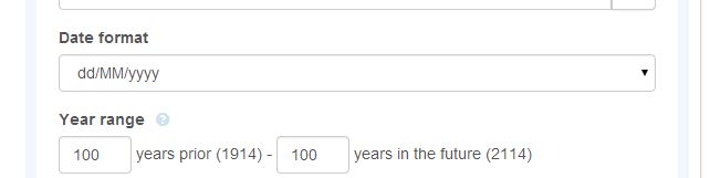

I have a Form that has a date field with the format dd/MM/yyyy.

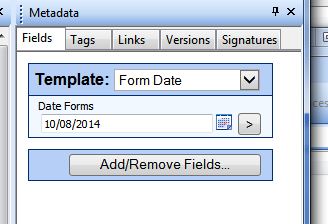

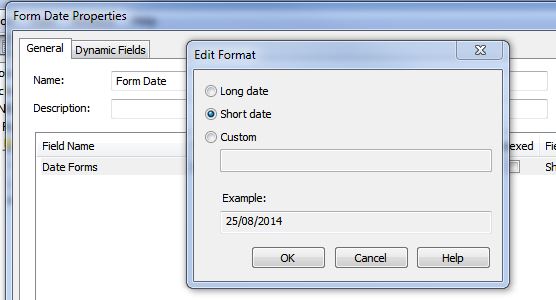

The associated Template also has a Date field with the short date format: dd/MM/yyyy
